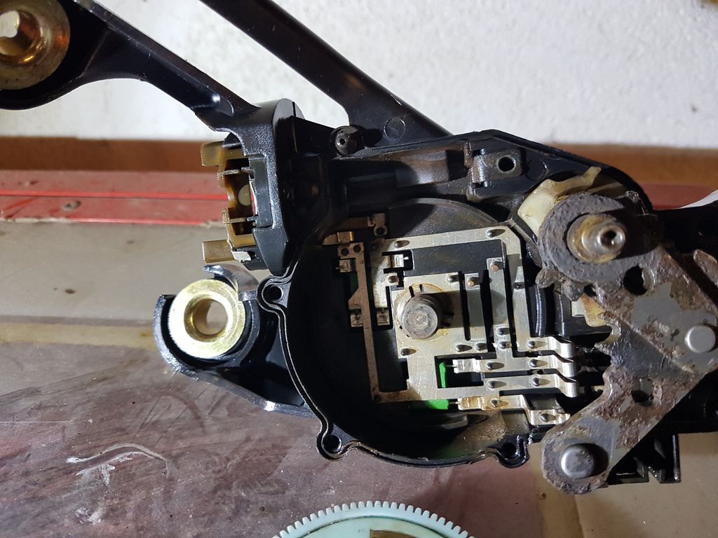

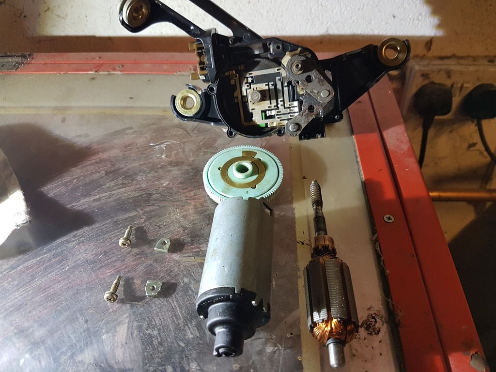

Remove the rear panel, and take off the rubber tube to the motor, before the one way valve, which is an inline black valve.. . Close the tailgate and see if the water comes out of the tube if the wash is operated. If it comes out of the tube, your getting water to the tailgate. Remove the tube off the wiper motor, and add the one way valve again... operate the washers, remembering to close the tailgate... No water, its the one way valve. Water comes out, its a blockage within the motor itself. You can strip it down but its a pain in the arse. I did, and cleaned it up. There is an array of contacts behind the drive cog, that enable electrical switching of the wash wipe motor, and this one ws in a poor way. Cleaned up it all started working.. Your job is just a process of elimination.
