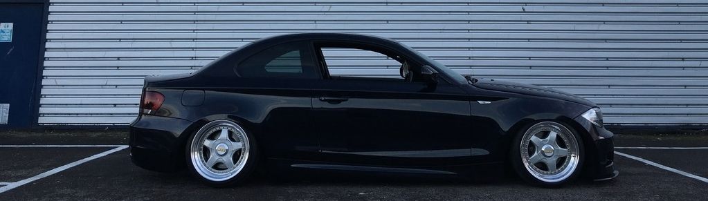

no its not even crazy low.... can still see top of tyre and there is a slight gap with the arch.... and yep have gaz on my e30 and they are fine and also have em on my audi..... just cant work it out to be fair

Post by THETYRANT » Wed Mar 22, 2017 8:30 am
Are you on stock Antiroll bars ? that's only thing I can think that would extra stress these lugs but even so should be able to handle upgraded bars, do you drive or park on steep ramp angles a lot ? I had an ARB snap once on my old Evo when going diagonally across a steep ramp down into garage forecourt but it was an old bar which didn't help.
It looks to me like the lug on coilovers are not strong enough or welding not upto scratch, have you a picture of the coilover where it snapped off as well ? also what did Gaz say when you contacted them ?
