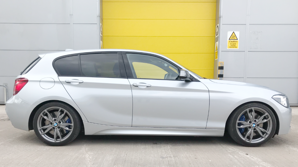

Finally got round to fitting the B14 coilovers at the weekend.
Installed the shorter M Performance bumpstops on the rear and M4 LCAs up front.
Impressed with the results so far, still need to get the alignment done but definitely corners much flatter with sharper turn in. The rear feels a lot more planted over rough B roads where it struggled before.
The ride is slightly firmer but in no way too harsh.
Before:
After:
Front - 25mm
Rear - 30mm
