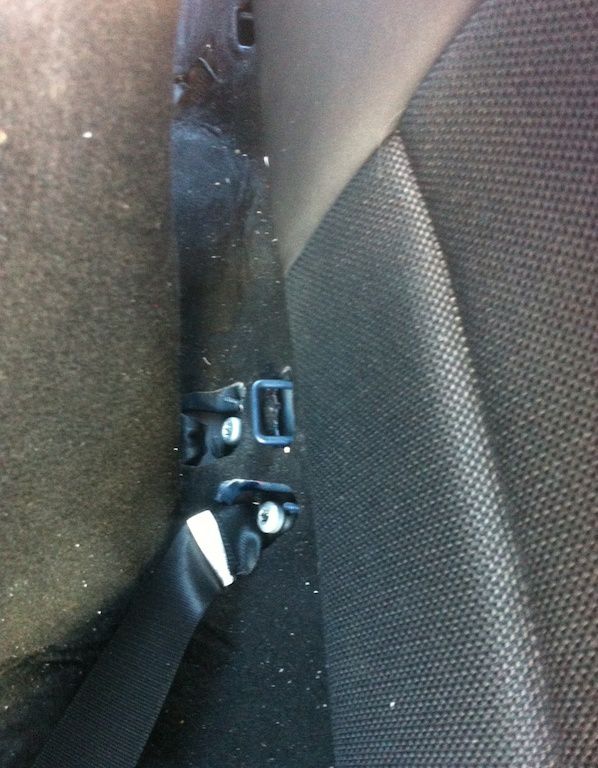

Wet rear seats
This is most likely to be down to the rear filter (see below, "Various dash board lights and PDC Error"). Water stores below the rear seats and comes up through these threaded holes
Inside car. Leaking seatbelt-bolts:

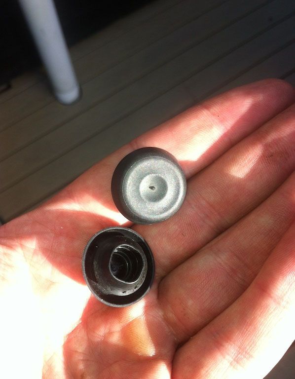

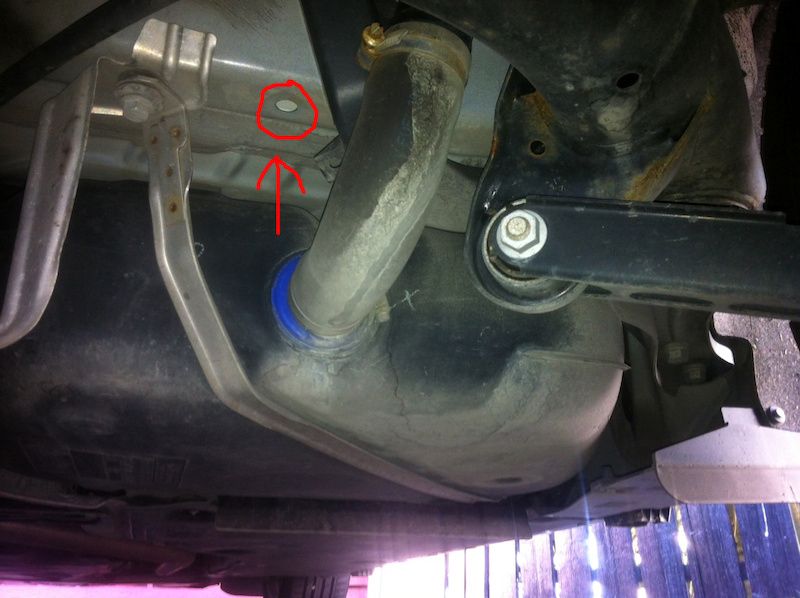

Underneath the car there are two plugs, take these two plugs out and allow any water to drain out.
The plastic plugs:
Once you have done this, see "Various dash board lights and PDC Error" to check the rear filter

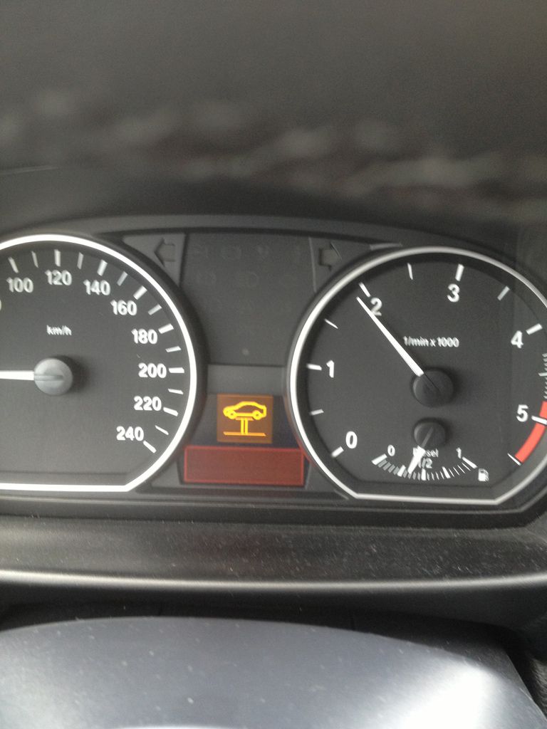

Various dash board lights (Christmas lights effect) and PDC Error
This is most likely to be down to a wet PDC unit located in the boot. This could be due to the filters in the wheel arches being fitted upside down by BMW.
The best way to see if its this, is to check your PDC unit
