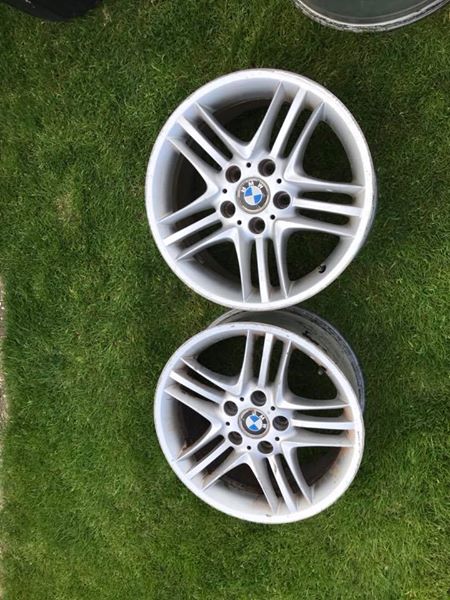

I'm asking this on behalf of a friend of mine, he found a set of style 89 online and wonder whether they will fit okay on 1 Series F20? Will there be any issue at all?

Depends on the Style 89's? Some are ET47, others are ET20!

Oh not sure which one but it was from a 330d, but it's this picture

3er E36 8x17 ET 47
3er E46 8x17 ET 47
5er E39 8x17 ET 20

Sorry It was from a 330d series, can't seems to get a bigger picture.
Posts: 50589
Re: Will 17" style 89 wheel fit F20s?
Post by marco_polo » Wed Apr 25, 2018 8:19 pm
If they're 100% from a 330d, they might fit. Which brakes does he have?
