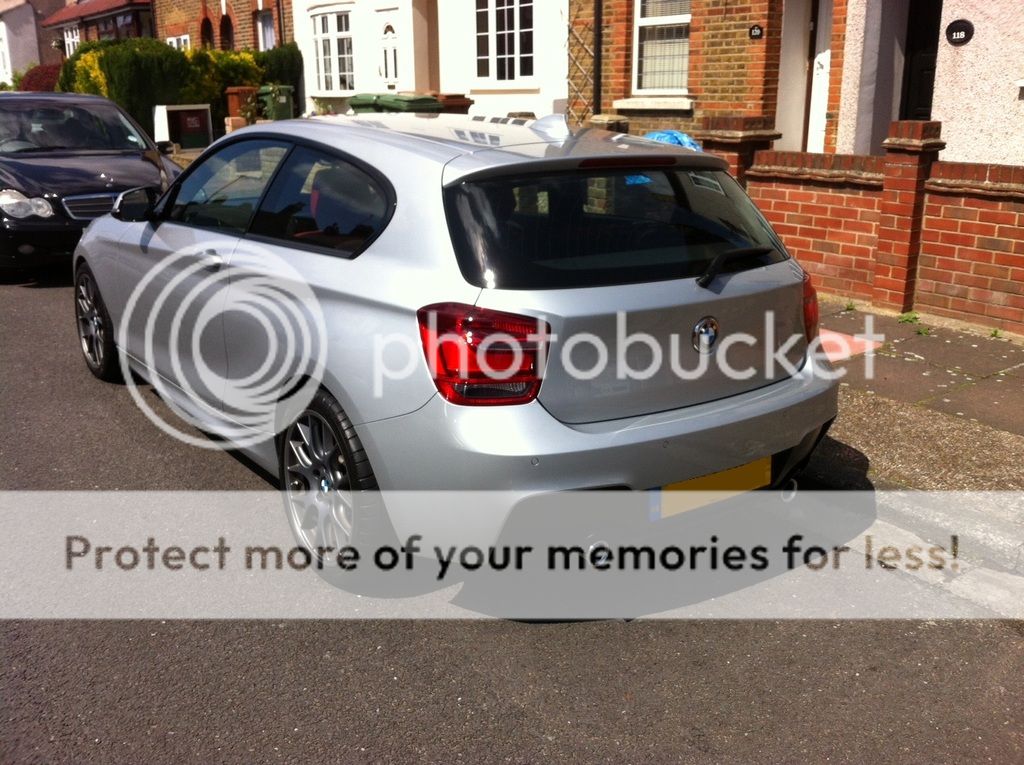

Post by marco_polo » Thu Nov 24, 2016 8:00 pm
BBS CH-R
18 x 8" ET40 square, wearing 245/35 boots:

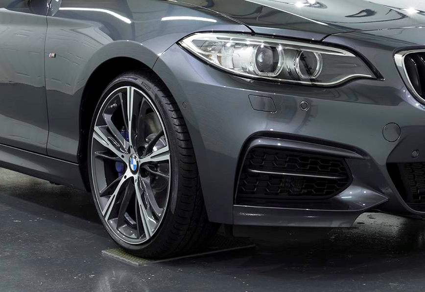

Post by moulin12 » Thu Jan 19, 2017 5:18 pm
660s
