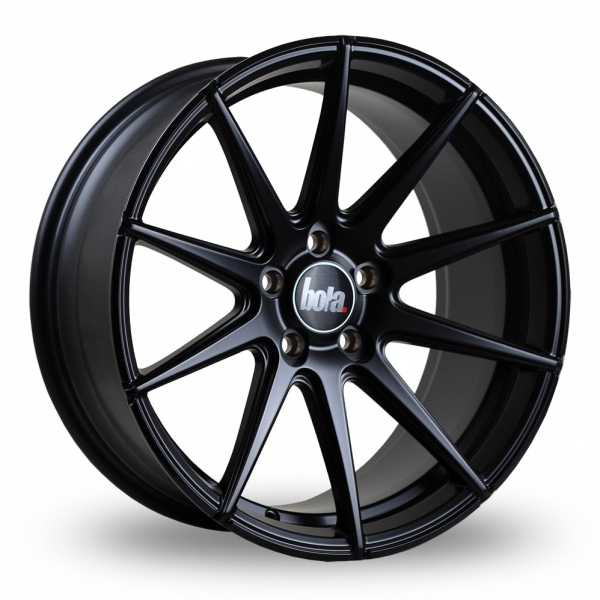

MattM140i wrote:
Sun Jun 18, 2017 8:44 pm
Is anyone able to tell me if BOLA B9's or Bola CSR's will clear the M performance calipers on my M140i? Going for 18" 8J ET40 all round on either set.
Just going to use stock Mpss tyres too.
Ordered some matt black 8x18 ET40 Bola CSR's today.....will only get them late next week so not sure when i'll be able to get the tyres (stock MPSS) swapped over but i'll put pics up once i do.
If the image really shows a 8J rim, that concave, imho you will have problems with ET40.
Hoping to be wrong...

Post by duckson » Sat Jun 24, 2017 12:17 am
That's probably the 9", the 8 is obviously less concave. There is people running the 8" all round fine.
