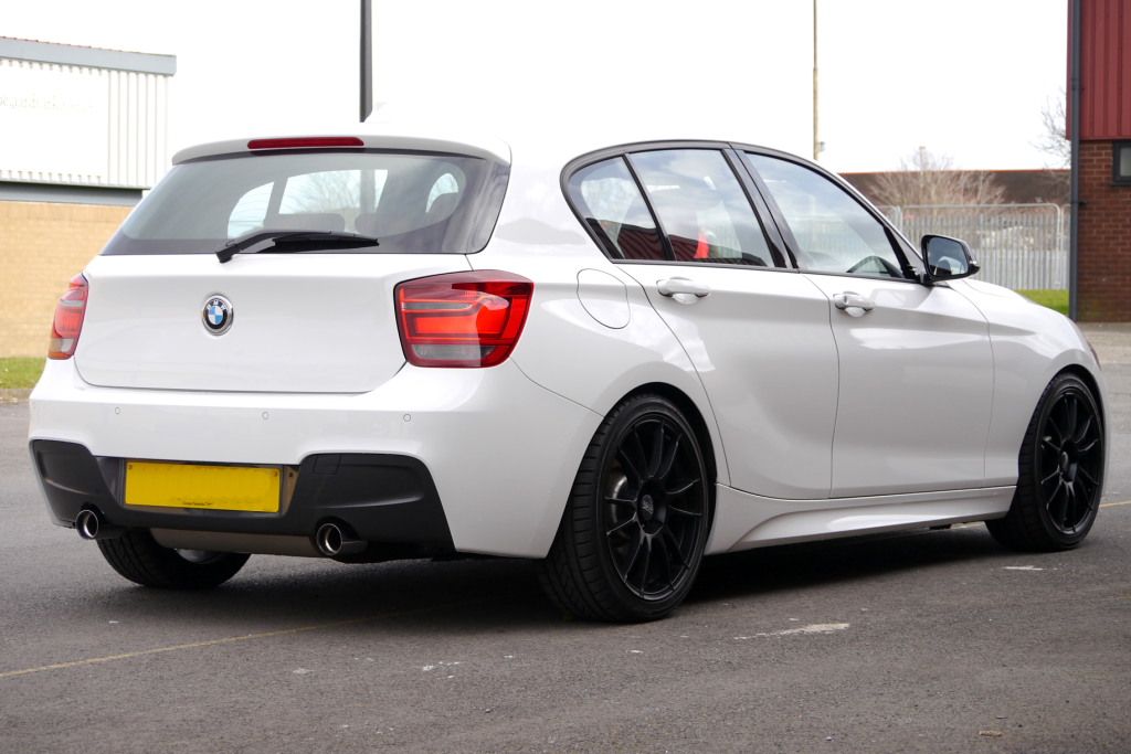

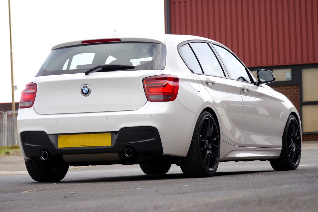

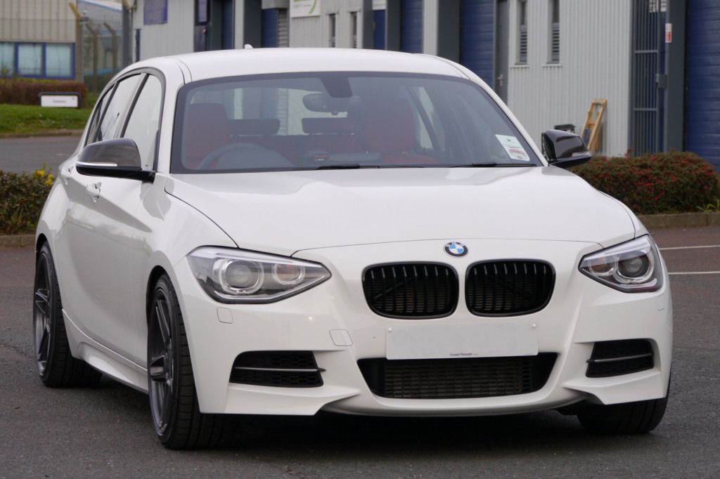

Some pics that perhaps I should have posted -
Advan RZ 18x8 ET45 (with 5mm spacer) front and 18x9 ET50 rear with 245 & 265 tryes respectively
ImageP1020037 by sootyvrs, on Flickr
ImageP1010998 by sootyvrs, on Flickr
ImageP1020051 by sootyvrs, on Flickr
ImageP1020016 by sootyvrs, on Flickr
ImageP1010990 by sootyvrs, on Flickr
My BabyBMW's with some Pork inbetween :D

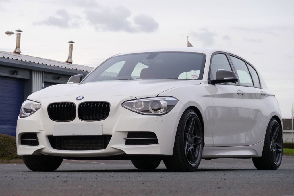

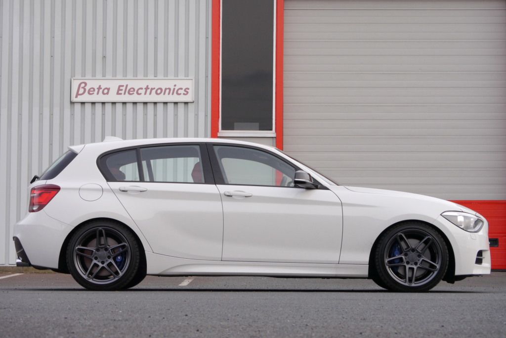

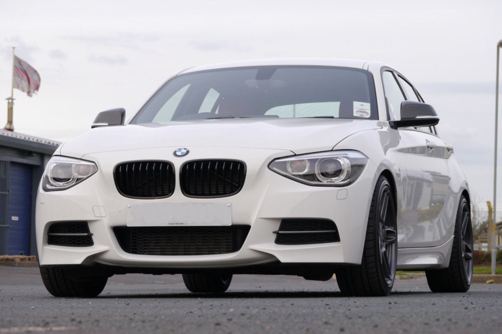

AC Schnitzer Type 3 18x8.5 ET43 (with 5mm spacer) 225/40/18 tyres

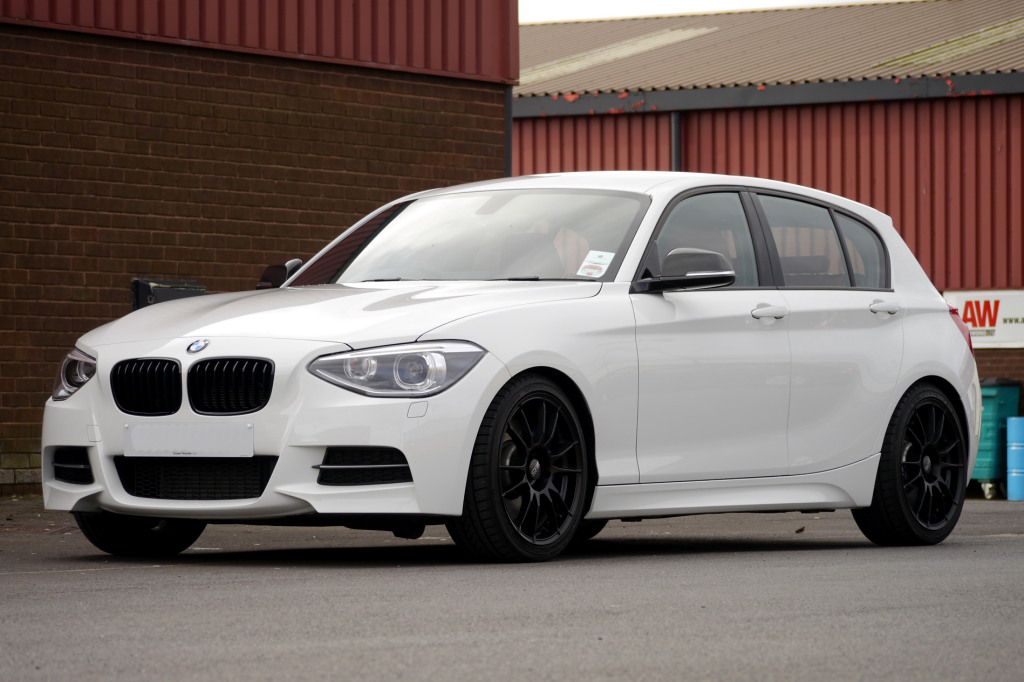

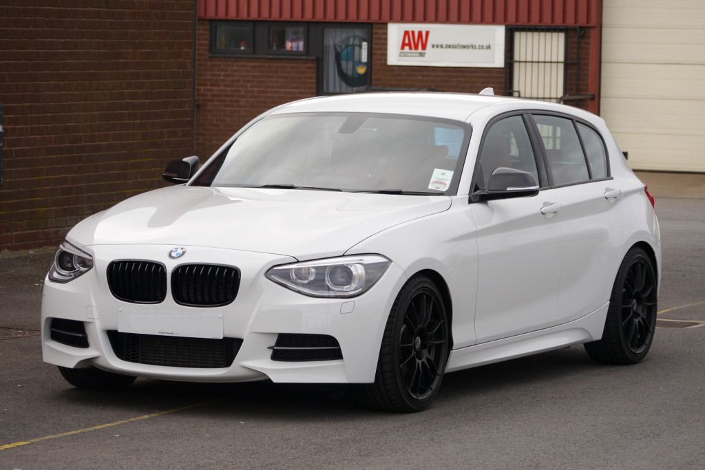

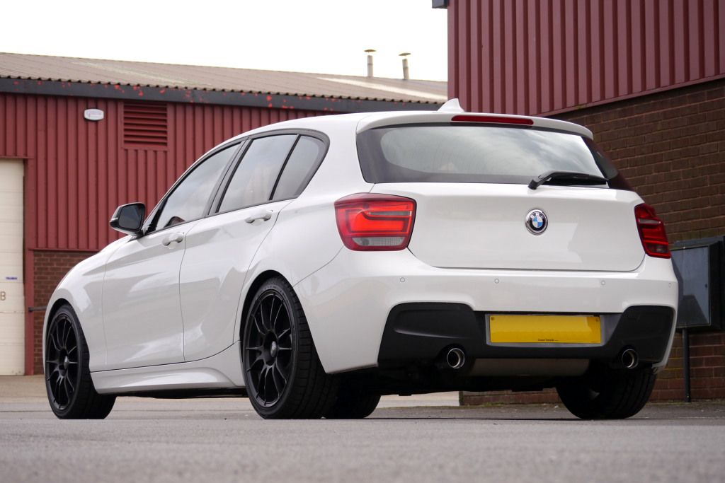

Some pictures of my car when it used to have OZ Ultraleggeras 18x8" ET40 all round with 225/40/18 winter tyres on :)
