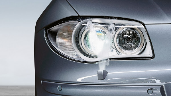

Headlight washers are simple to spot
Static
Pop up

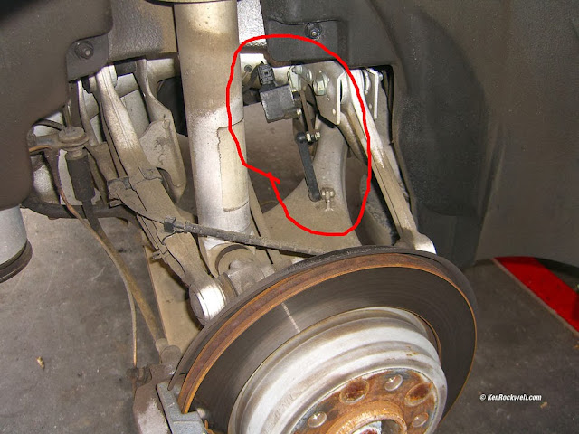

Self levelling is harder to spot. You can look for the lever connected to the wishbone which monitors the pitch of the wishbone, however theres no real test to check whether it is working correctly. You could try a bumpy road, but I'm not sure how effective or accurate that test is
