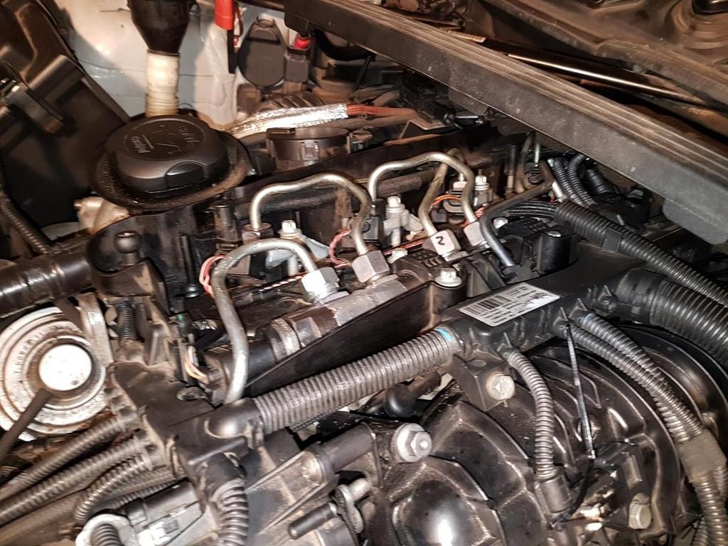

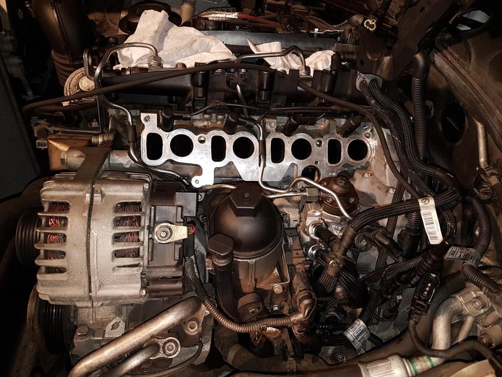

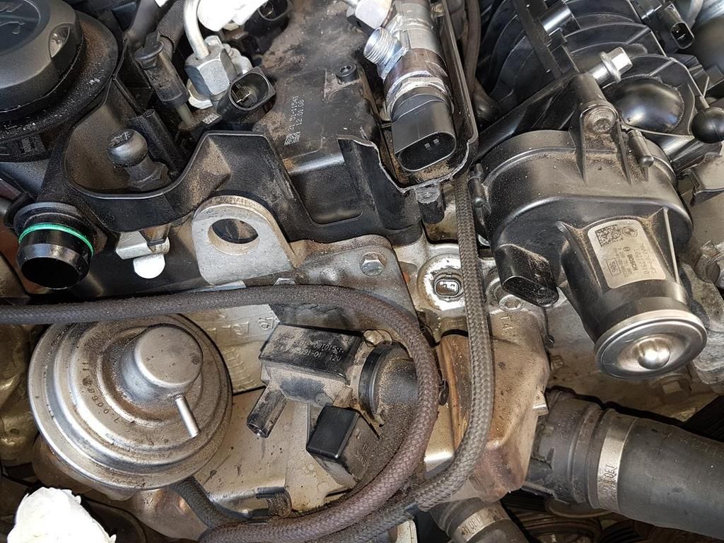

Fitted the CP4.2 pump on the weekend,
Here's a few pictures of the job.
I bought a 2016 model CP4.2 pump on Ebay woth only 6000 miles on it but has one outlet facing the opposite direction, This worked out very well though as there is nothing in the way on the rearward facing outlet plus it means you don't have to move the glow plug control unit out the way like you do with the model which has both outlets facing forward.
I also bought the two fuel lines that come with this pump, one is a direct fit and the other I bent so that it is routed under the inlet manifold and looks tidy. Image

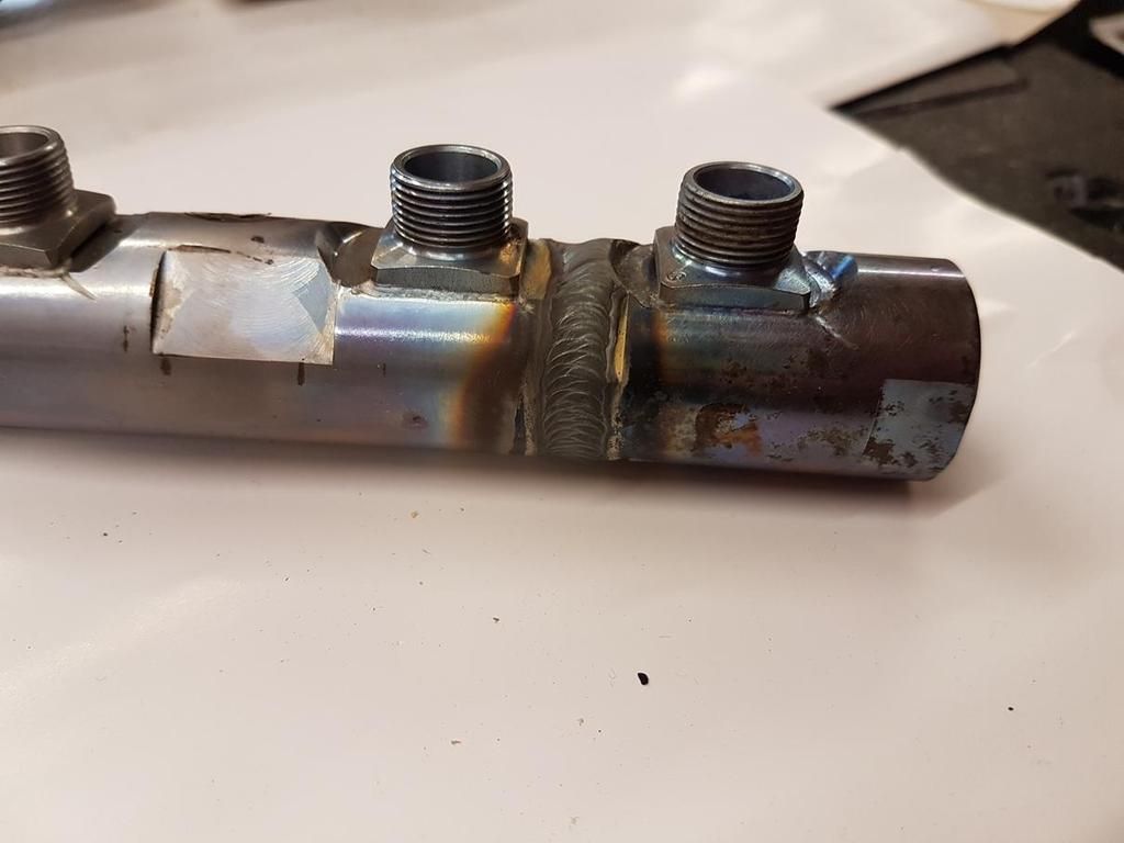

I also bought two fuel rails the same as standard fit and had them cut and welded. Image
By using the same 4 cylinder rail all the standard rail to injector pipes are reused plus it sticks out far less from the front of the rocker cover than the 6 cylinder one. Image
I bought another EGR pipe too, so that I could have it capped and ready to 'beat up' when the operation commenced. The egr is electronically deleted but I had the intake end welded just incase it didn't seat properly in the head... but it did and now it doesn't protrude into the throttle passage either to cause any obstruction to the intake air.
All done, No leaks and the cover fits fine
