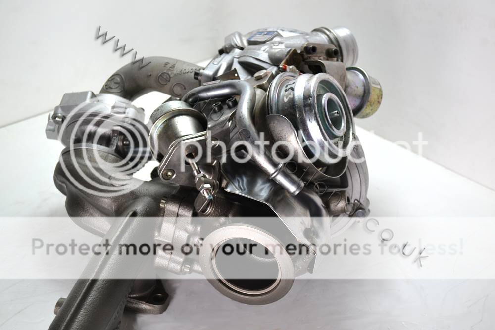

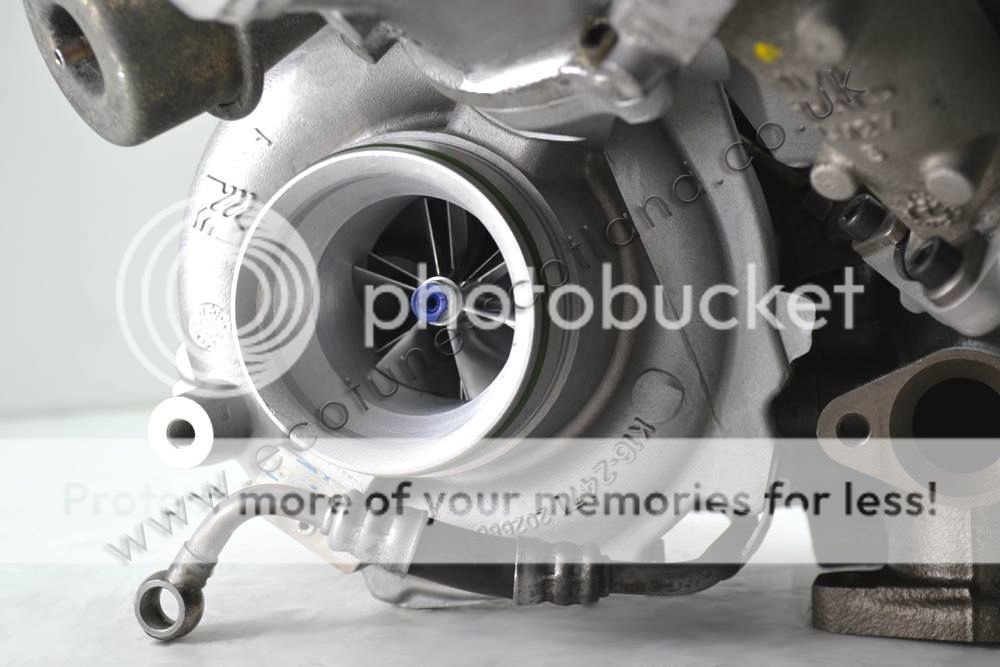

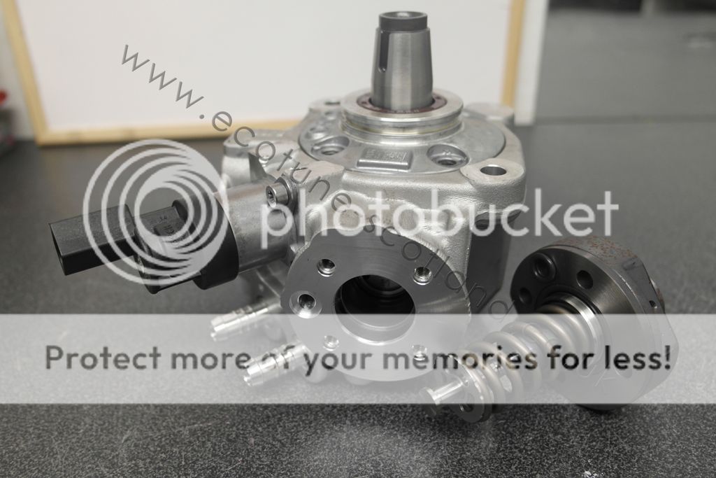

Please forgive my neglect as I have not posted on the board for quite some time. This is mainly because we have been so busy beevering away developing exciting new products. We intend to have the most powerful N47 2.0 diesel running on pump fuel in Europe. The target is at least 350hp with 50mpg in normal driving... our hybrid turbochargers are already built however, we have found that this engine runs out of fuel volume at 280-290hp and it is quite simply impossible to produce any more power without upgrading the high pressure fuel pumps.... don't worry... they are in development and should be released as a new Ecotune product around May!

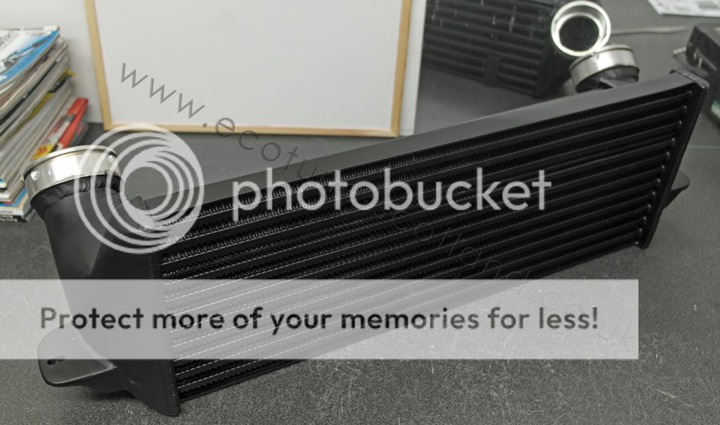

Some great news to begin with... we have been working closely with friends in Germany regarding the best possible intercooler solution on the N47 engine... why Germany? We sampled a few others available to us in the UK and we were either met with a lack of willing to assist in our development or the results simply did not make for a viable product.
Now to put things into perspective, with an ambient temperaure of 15c a 123d running stock software will see temps climb on the dyno as high as 60+c, add to that a software calibration and of course these temps get even higher. Our revision 1 development intercooler we saw temps drop to a max of 45c which is of course a phenominal result but we wanted better so after providing our findings to our cooler developer back came revision 2, this time again with an ambient of 15c the intercooler peaked at a maximum of 36c! Revision 2 it is!
To make matters even better we have put the first 100 units into production. Anyone who would like to view the datasheet can get in touch at info@ecotune-scotland.co.uk
The intercoolers will be finished in understated matt black and we will be happy to release the first 10 at a discounted rate to BabyBMW members...

How have you upgraded the fuel pump / system?

The n47's are all fitted with Bosch cp4 fuel pumps and we are hoping that we will have a kit available where the internals can be replaced. This is still in development. Naturally it would be simple to fit an n57 dual piston fuel pump but not everyone has £1000 to spend on a pump and of course then an additional 2500bar pipe is required to feed the rail not to mention having to tap it with an additional rail input and the additional r&d/manufacturing costs involved.
Upgrading the stock pump using replacement internals to supply 30-40% more volume is more than enough to achieve our goals and we will of course keep everyone updated on this progress.
