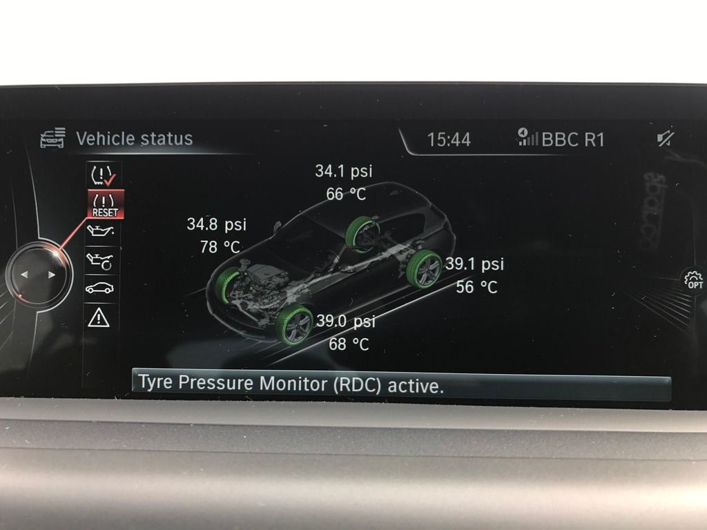

Mine got really hot (I know there’s too much pressure in) but they never felt like they dropped off...it was more the brakes that were the limiting factor - the pedal was long pretty much all day, however it was a very hot day too

Quadrapete wrote:Image
Interesting when looking at pressures advice to consider the loaded tyre and reduce pressure further, your pic a good example of that take it was a clockwise track !!
How was the wear on tyre ? How long were you running for ?
