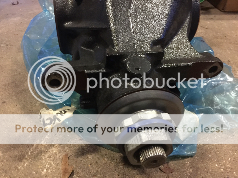

Mike Roberts
Posts: 2607
Joined: Sat Dec 15, 2007 7:47 pm
Location: Cheshire
Re: lsd
Postby Mike Roberts » Mon Jan 09, 2017 2:56 pm
You remove the standard diff when fitting the MP-LSD. Mine's in the garage waiting to go back on. It isn't exchanged or fitted in lieu of. You buy a whole new sealed pumpkin and internals to swap out.

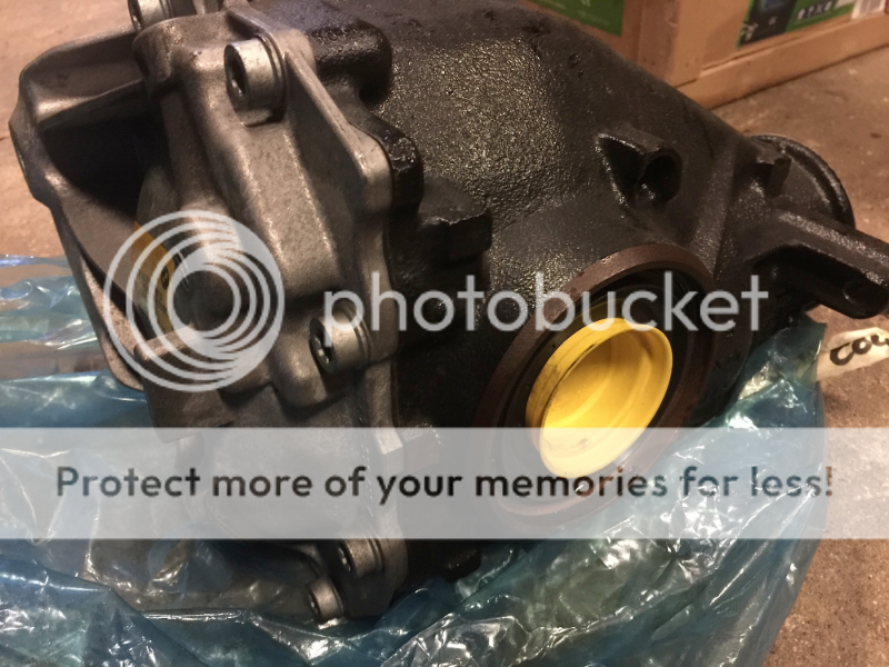

Posts: 45022
Re: lsd
Postby marco_polo » Mon Jan 09, 2017 6:31 pm
docwra wrote:Not if its specced like that from factory, thats what I was getting at :)
You can't spec them from the factory, dealer fit only.
They put the stock open diff in your boot, sealed up with yellow plugs ^.

gavp
Posts: 554
Joined: Fri Feb 22, 2013 5:52 pm
Location: Gloucestershire
Re: lsd
Postby gavp » Tue Jan 10, 2017 1:45 am
Smells disgusting too, hate changing diff oil.

docwra
Posts: 312
Joined: Wed Sep 17, 2014 4:28 pm
Re: lsd
Postby docwra » Tue Jan 10, 2017 8:37 am
BMW in generousity shocker :shock:
