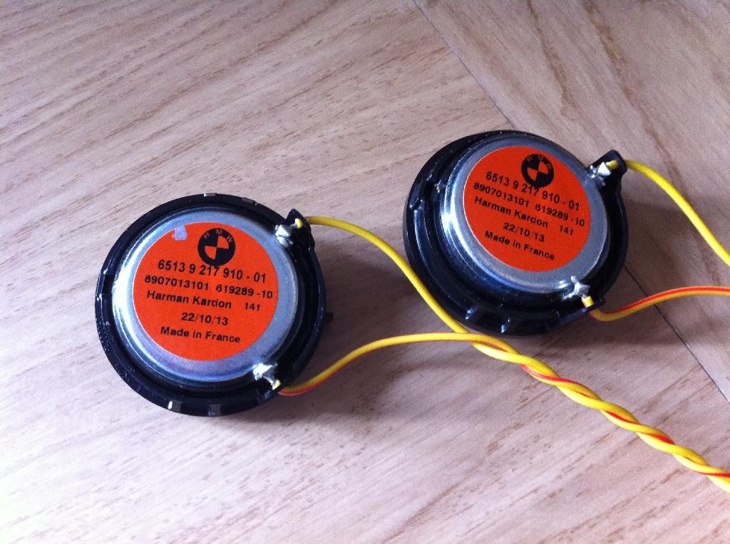

The 013 (Professionsl) Tweeters are HK, the 012 (Business) versions aren't.
An old group buy with some useful part numbers: https://www.babybmw.net/viewtopic.php?f=18&t=28293
