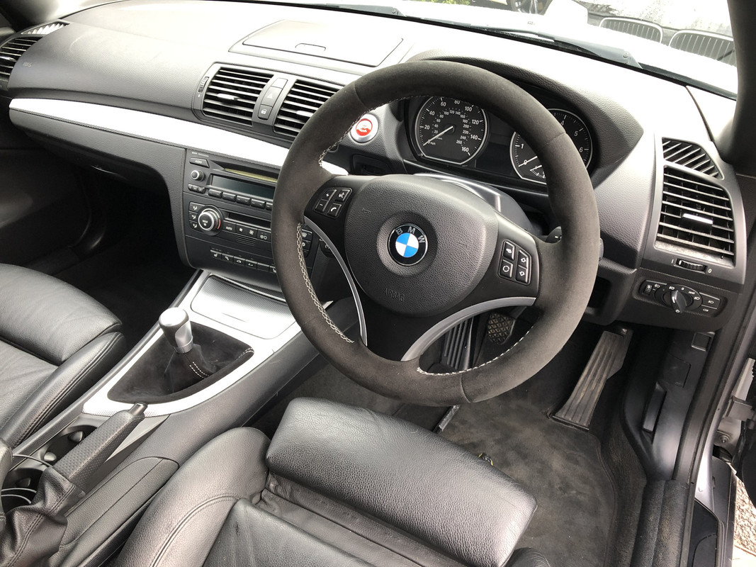

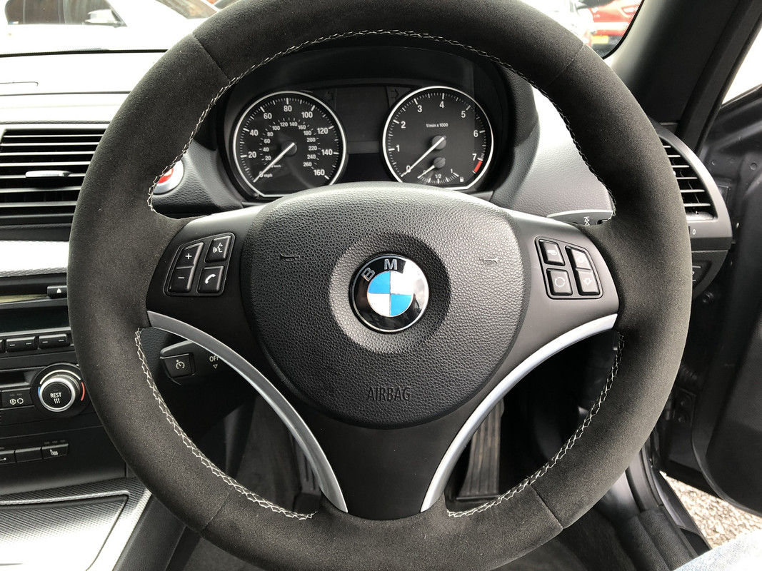

Which means I can fit the alcantara wheel from the 116 (will do it whilst I’m pissing about with the battery).

I fitted the alcantara wheel from the other car today (I’m a dab hand with with these now). Looks great and feels nicer than the shiny old M Sport wheel with it’s worn trim.
It was pretty manky behind the wheel with lots of fluff and pet hair. Nice.
