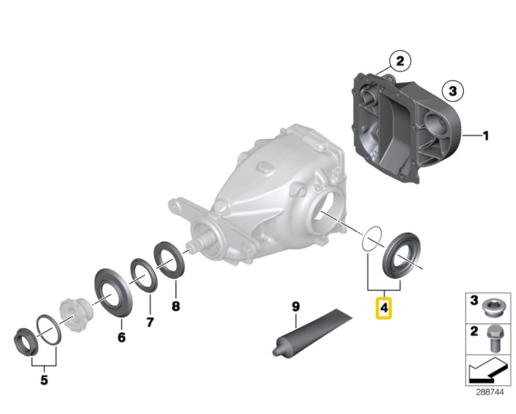

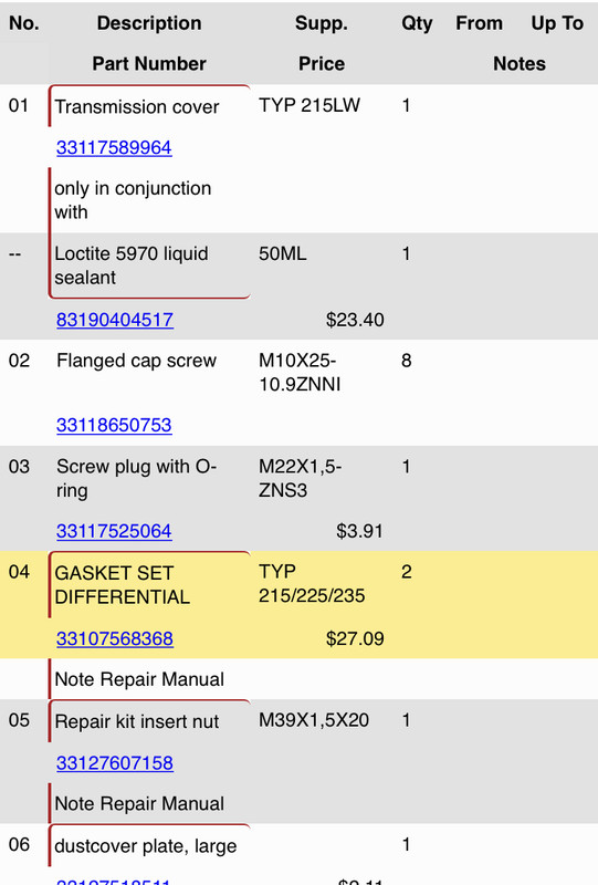

marco_polo wrote:
Mon Jul 16, 2018 11:58 am
The Auto Diff is different, it's probably the same plug though, check part numbers on Realoem.
This is all I can find on realoem for the M140i but I’m unsure how to get the parts diagram for the mperformance lsd
Going off that diagram it’s the same size plug yes?

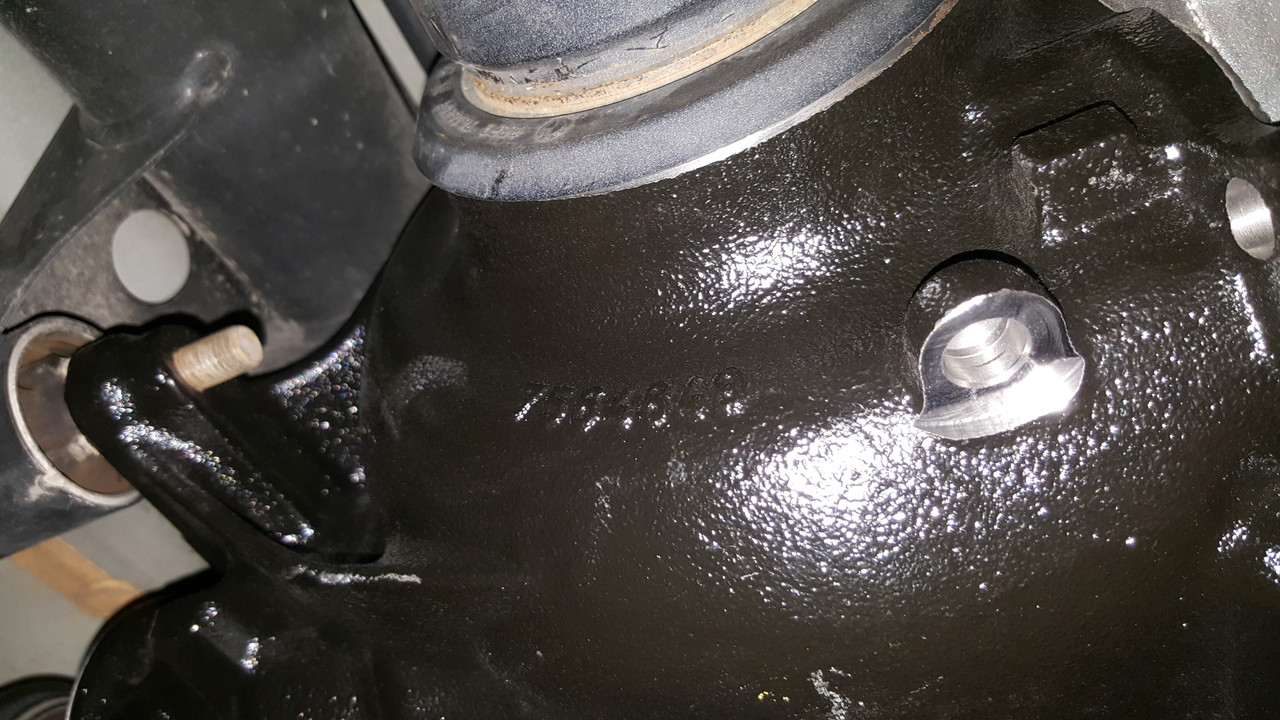

Might be slight of topic but related to the M performance lsd. Is it possible to identify the M performance lsd in any way?
My belief is that the housing is same as standard and part no sticker is hidden away on top.
Williams327
Posts: 328
Joined: Mon Jan 04, 2016 4:26 pm
Re: How To Change Your Diff Oil
Post by Williams327 » Mon Jul 16, 2018 1:02 pm
mr_apex wrote:
Mon Jul 16, 2018 12:45 pm
I can get a picture for you later if you like? Got my standard diff in a box in the garage and lsd obviously fitted on the car
M140i 3 door Auto
Mods - Dervtech, JB4, LSD, underbody brace, BCS catback, Decat, AFE intake, auto id mirrors>diffuser, kerscher splitter, carbon spoiler, Mp skirts>blades>grills, OZ ultraleggeras, H&R -25mm, M4 pads, braided lines

Williams327 wrote:
Thanks that would be great!

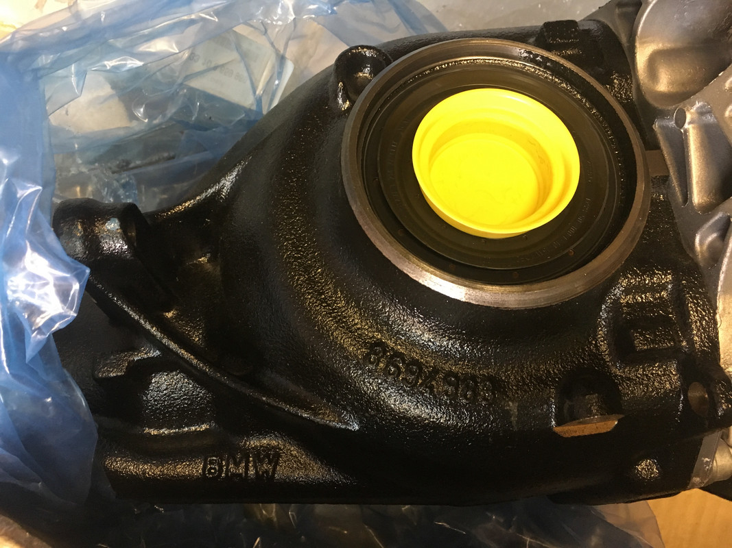

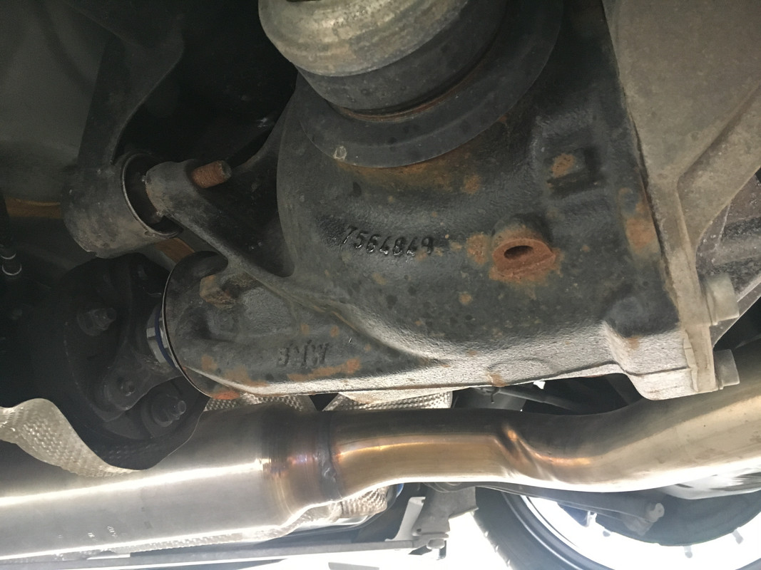

So these are the only codes I can see on the two diffs. The Lsd is the dirty one the standard open diff is brand new

Thats strange, I have same number on both of mine, seems to be lsd number of yours.
In my pics open diff is dirty and the cleaner one is M performance lsd. Ive an m135i, you got the m140i right, might have been updated unlike the lsd thats older?
Is it possible to see any of the internals when removing plug and changing oil or how could it be verified?
